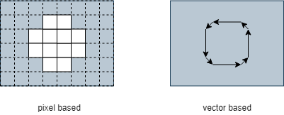

Software packages that perform 3d print job preparation usually import parts in the industry standard .stl format (triangles with coordinates in XYZ forming a triangle mesh) and output a file or a set of files that a 3d printer can understand. Most machines require a file that has a "per layer" instruction of what to print. The process of going from a 3d triangle mesh to a collection of 2D layer instructions (slices) is called 'slicing'. The output from a slicer algorithm is usually one of two flavours:
  • Pixel based format (for example .png images)
  • Vector based format with the coordinates of cross sectional contours. (for example .slc, .svg, .gcode)
Figure 1: Pixel versus vector based slices
This article will explain two different slicing techniques that are used in slicing software nowadays. What usage applications they are best for and how this all impacts slicing speed and quality. It is based on our experience with Formware 3D and after 3 years of improvements in slicing algorithms.

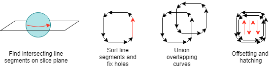

The first method is used by a lot of slicing software in the market and slices your triangle meshes on the CPU (Your computer's processor). That is, all the calculations happen mostly on the CPU. The algorithm to generate 1 slice is roughly as follows:
  1. For each triangle in your mesh check if it intersects with the horizontal Z plane of the current slice. If so, calculate the line segment following from this intersection. This is part of the cross section that needs to be printed.
  2. Sort all the line segments for the current slice to form closed polygons. Try to repair any polygons that are not closed or contain other errors.
  3. Union all overlapping polygons and sort out which ones are holes and which ones aren't.
  4. Optionally perform any contour offsetting (walls) and hatching (filling) operation if your printer requires this. Usually laser/fdm printers require this step and it is very costly in computational time.
  5. Export in either of the 2 formats:
    • vector based formats (.gcode, .svg, .slc)
    • pixel based (.png). For this an additionally 2D image draw and fill operation is required to convert all polygons to filled polygons.
At least steps 1-4 are performed all on your CPU. Optionally step 5 as well. We've summarized the steps in the figure below:
Figure 2: Slicing geometry on the CPU

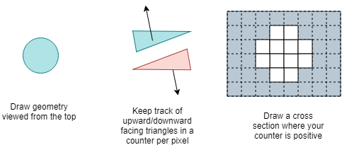

The alternative slicing technique is to let the GPU (your graphics card) do a lot of the heavy lifting. The limitation of slicing on the GPU is that it creates a pixel based output only. A detailed explanation goes to far for this article but the algorithm for generating the slices is roughly the following:
  1. Make sure all geometry data (triangles) are loaded onto your GPU. This is usually already the case if you are viewing your parts in a 3D View. So this only happens once when loading your part
  2. Per slice, draw in top view your parts on a specially created pixel buffer (the size of your pixel output.). For each triangle that is drawn, the normal vector tells us if the triangle is downward or upward facing. By keeping count of these two face orientations the GPU can determine if a pixel is inside or outside a model.
  3. The last part is transferring the generated pixel data from your GPU to your computer memory and saving it as your image based output. (.png slices)
Figure 3: Slicing geometry on the GPU
